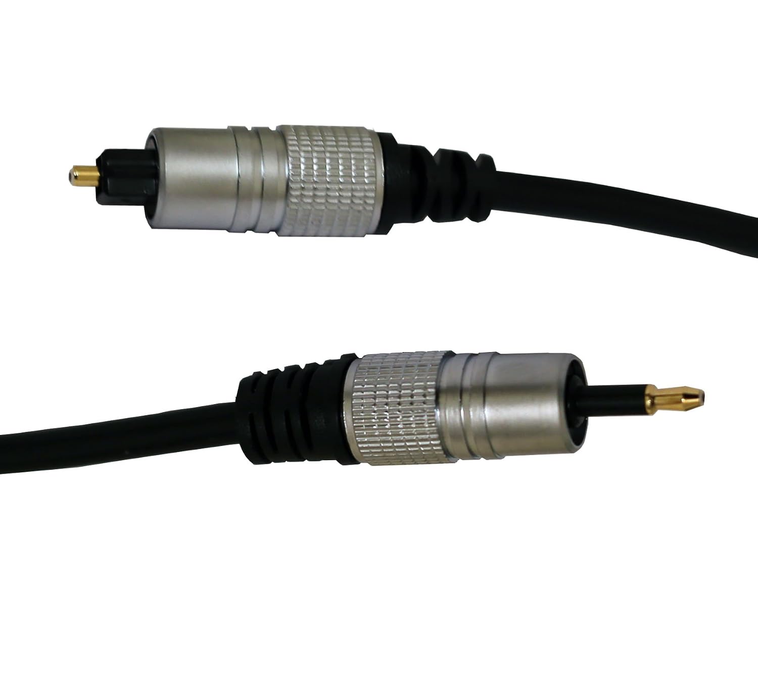

There are plenty of good news.
All MD units have an optical "mini-jack toslink" in. The recording quality is so good (even considering a compression) that you can consider to buy a very good digital cable (jack 3.5" to mini-jack) like an Audioquest Forest. Same thing for the headphone. If you use it as a portable unit,  buy also a carying pouch (with at least one hole to connect the headphone) to prevent scratches (a lever cigar boxe is even possible). And use it gently every time you open it to change the disc or use the buttons. Doing that you will be able to resell the unit in some years at the same price you bough it. About the recordings modes, there are different "schools"  here about what is the best for you (not only for the quality but also for  question of storage, time, full universality between different generation of all your units, etc). The best news is that it is still quite easy to find (cheap) standard MD discs (no need of only sealed ones) that can be formatted in Hi-MD mode (or not), 1 Gb Hi-MD are nethertheless quite rare and expensive nowadays. And finally you will use a vintage audio device that will last a loooong time with you (if you use it gently). Beside another less expensive portable unit and  a (good) deck are warmly advise.
