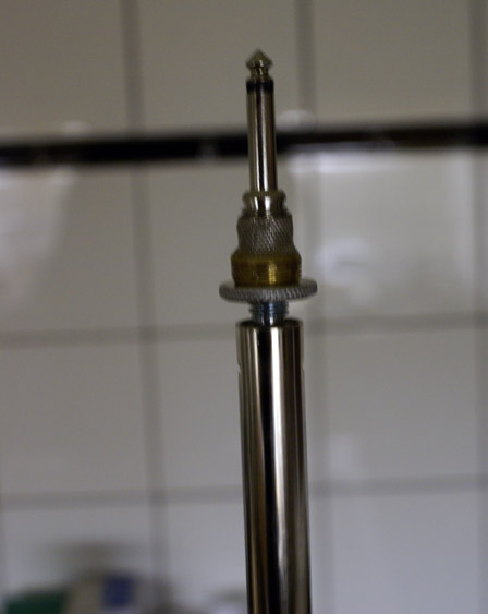

PLUS I built my own design mic stand adapter. Just glued a 6.3 mm jack onto a mic adapter with 2 component glue (epoxy). Obviously I need to be careful not to kill the 6.3mm input, so treat with caution, but this works rather well actually.
LOL ........ " Necessity ,... The Mother of Invention "
Yah mon , I would be treetin dat , like baby cobra gentle mon .!
