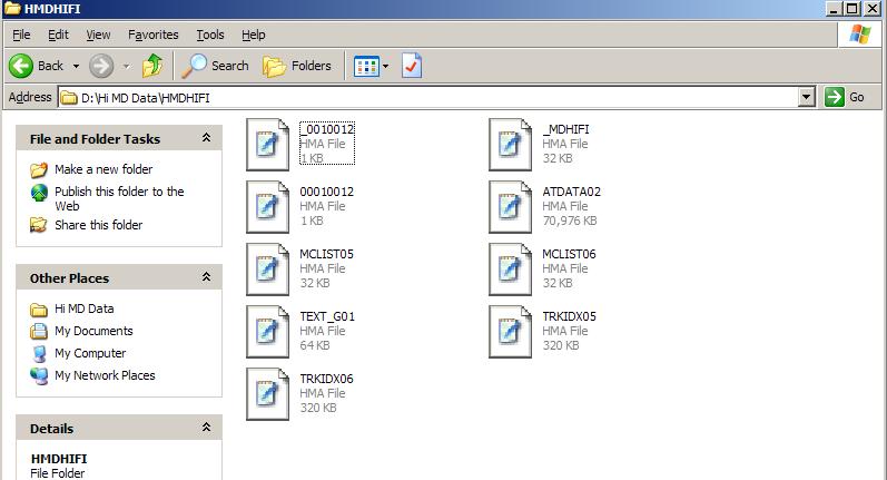

Aashish Posted September 2, 2005 Report Share Posted September 2, 2005 I also lost my valuable live recordings from My MZ-RH910. It corrupted the disk in the same way as described by BruceC. I recorded about 2 Hrs. audio on a standard 74 min. disc in Hi LP mode. today while transferring the tracks (60 tracks), after 2 tracks sonic stage gave an error messege "error tranferring tracks" and erased all the tracks from the md. I closed sonic stage and open Hi-MD Folder from My Computer and copied all data from it to my computer's hard disk. Then i removed the md from the unit and close the write protect tab. Now when i am trying to use that md sonic stage gives an error "Cannot use this disc as an audio disc because it was initialised by a program other than sonic stage....."Is there any way to recover my recordings. These are very valuable live recordings for me. I tried to transfer those Hi-md files to another blank md but could not recover anything. Does anyone know what to do with these files to recover audio from them.Snapshot of these files are attached. (which i copied from corrupted md to Hard Disk)RegardsAashishMy MZ-RH910 did the worst possible thing -- it corrupted the disk during upload. Anyone figured out a way to recover a disk? This is the first disk I've made and, if I can't fix the disk, I'll never use the rh910 again.I don't think this is my fault. I had about 5 hours of live music recording on the disk from a one week music workshop I attended -- this disk is important to me. I had listened to the entire disk so I know the music was there. I had already uploaded about 20 tracks (of about 150 total) so I think I knew how to use Sonic Stage. I haven't checked the Sonic Stage version but I bought the rh910 just a month ago from Amazon, so I would assume it is fairly up-to-date. The rh910 was plugged directly into my computer's USB port, not through a USB hub. The rh910 was NOT plugged into the power (besides the USB) because, to plug in the USB, you have to close a little door that prevents you from plugging in the power supply. The USB is supposed to supply the power. The rh910 battery indicator said the battery was fully charged. I started a multi-track upload. The first track uploaded successfully but then the transfer stopped and an error message appeared saying the disk did not have a recognizable format! Now, I cannot even play the disk. At the moment, I am very disgusted with Sony and the rh910, and I would not recommend buying one.← Quote Link to comment Share on other sites More sharing options...
