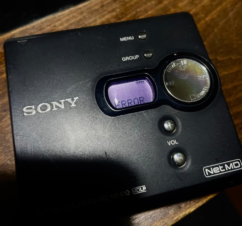

Roberto Castro Posted June 21 Report Share Posted June 21 Hello everyone. I'm an idiot 🤦♂️. I followed this guide and ended up with the error message in the photo on my MiniDisc. https://www.minidisc.org/sony_mzr_reset.html It doesn't even move or makes the sounds of moving parts. Please help me get my device working again 🙏 Thank you very much. Quote Link to comment Share on other sites More sharing options...
imkidd57 Posted June 22 Report Share Posted June 22 OK I couldn't understand some of the instructions on the link you gave; not surprising things errored out. Perhaps more importantly, yours isn't an MZ-R xx unit so the instructions are likely to be not the right ones. I suggest going to the Minidisc Wiki and download the service manual for your actual unit: https://www.minidisc.wiki/equipment/sony/portable/mz-ne410 On page 24 is the 'Overall adjustment' instructions and you can try to follow those. Normally I'd say do the preceding temperature and voltage checks but give the overall adjustment a go first - it might work. Quote Link to comment Share on other sites More sharing options...
