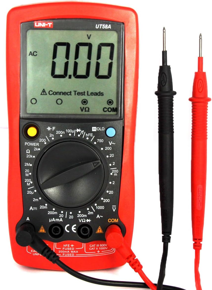

M1JWR Posted October 24, 2020 Author Report Share Posted October 24, 2020 meter is uni-t ut58a set to where it says 200m just below where this one is actully pointing Quote Link to comment Share on other sites More sharing options...
NGY Posted October 24, 2020 Report Share Posted October 24, 2020 17 minutes ago, M1JWR said: meter is uni-t ut58a set to where it says 200m just below where this one is actully pointing I get you. That's exactly the setting/range you need for measuring IOP on the jig. Quote Link to comment Share on other sites More sharing options...

sfbp Posted October 24, 2020 Report Share Posted October 24, 2020 "AC" on the meter???? Whoa folks.... Quote Link to comment Share on other sites More sharing options...
M1JWR Posted October 25, 2020 Author Report Share Posted October 25, 2020 24 minutes ago, sfbp said: "AC" on the meter???? Whoa folks.... nah its the section below that, thats just a refrence pic from the net, its the 200m position two clicks below where that one is pointing Quote Link to comment Share on other sites More sharing options...
sfbp Posted October 25, 2020 Report Share Posted October 25, 2020 Good, you had me really worried Quote Link to comment Share on other sites More sharing options...
